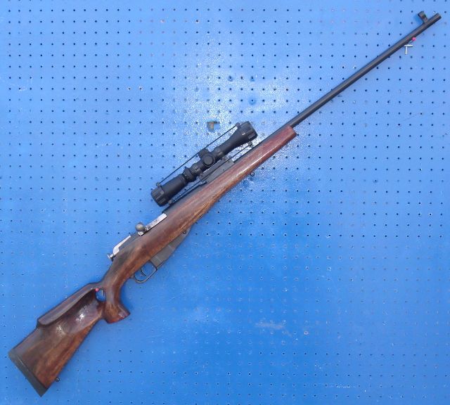

Purists look away...
NICE! What stock is that? :confused: I like it! :thumb:

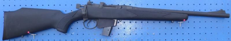

Meanwhile, I have an MN that isn't in very great shape that I'll cut down to 20" and either fit the barrel band back on the original cut back wood, or if it rings my chimes, I might even throw the loot for an ATI stock, bolt-on scope mount and put a cheap mil-dot on it.

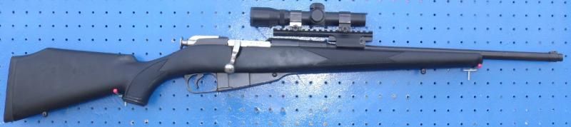

I bought this M91/30 in it's current condition. It came with all original parts and can be restored to Original Condition.
That is until I have the bolt bent.
S&K scope mount w/Pistol scope.
Huber Trigger.
Boyds (I think) Stock
I built two Identical M38 Sporters, back when they were $100 rifles.
I sold the M44 Stocks to finance the builds.
Other than the Bolt they can be restored with a new stock.
ATI Stock
Leapers UTG Scope Mount w/pistol scope
Bolt by "The Bolt Man", Smoothest Mosin bolt's I've ever cycled.
