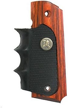

I did add the Pearce Finger groove insert.

Good gawd, why? :unsure: It makes the gun look fugly and isn’t necessary.

Here’s my stock Colt Series 70 model with stock grips. Note the absence of any fuglys. Tight shooter it is too. :cool:
