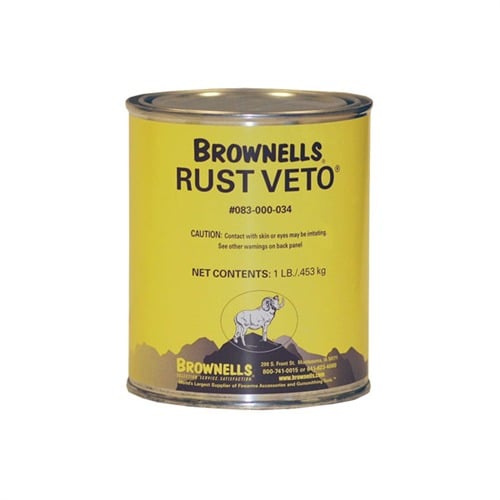

I have a new invention to protect guns in storage from moisture, Its called cosmoline. I heat it up and apply an ultra thin layer to all external parts, leaving the bore bare. If that gun is never fired, I would dip a nylon brush in hot cosmoline and coat the bore as well.
I bought mine from Brownells. Since it is no longer made, they now offer this product, and suggest it works just as well.
Btw, I bought a lot of wood/ blued steel gun when I lived in the desert. Now that I live in the Ozarks, I buy and hunt/carry only stainless guns.
