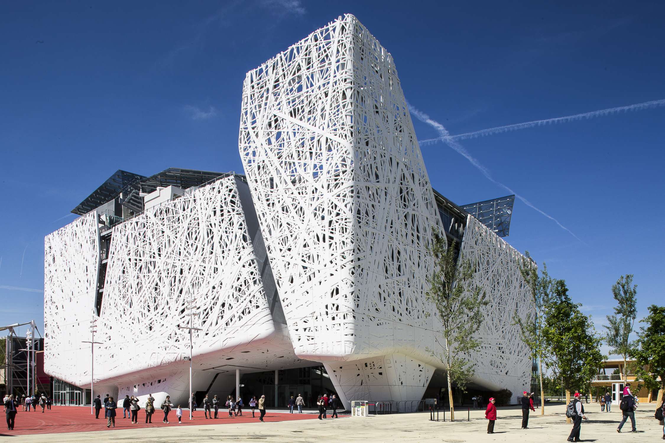

As to the overall "best" construction material, I advocate anthropogenic stone, aka concrete. The trick is to get it to cure in the shape of a house. Not a trivial task! Even Thomas A. Edison's attempt was somewhat unsuccessful.
However, if you're successful, you will have a house that is going to last centuries, require little maintenance, resist nature's wrath, and protect you and yours.
Some concrete variations that have superior performance : SCIP (like Tri-D-Panels); Helix steel reinforcement; smog eating catalyst; tilt up cast in place; and slip form.
SCIP
Habitat For Humanity once built using SCIP panels. Even Jimmy Carter helped build them. But HfH stopped. They're back to building wood frame fire traps and termite feeding grounds.
Hurricane resistance - photos of a house that endured a major hurricane
Better than rebar - - -
Titanium Dioxide catalyst also prevents ugly stains on your nice concrete wall.
One of the benefits of tilt up cast in place panels is the ease at embossing textures via mats, form liners, stamps, etc.
