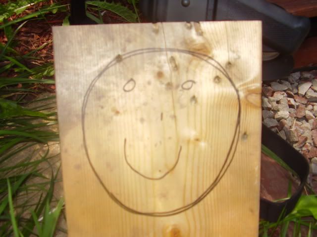

Just thought i would write a little about a new rifle i got a week ago Im sure all of you have heard about it allredy but i thought id throw my 2c in ,Went to my local shop and they had a century arms gp-1975.So,I hear some good and some bad things about century.I liked the rifle but following my instincts i left the gun went home pulled out the old laptop and went to work.they are built on romanian guard parts kits with a new barrel from green mountian,new receivers from (cant remember)Tapco g2 trigger group,all black furn which i dont either love or hate but can live with.Went back and bought the rifle paid $530otd came with 2 mags and the guy threw in a couple boxes of ammo and i bought another 8.Got home took it out into the field set a scrap peice of 2x8 agianst a tree drew a smilie face backed off 100yrds give or take.opened the box loaded the rifle fired a few rounds.from a standing position wasnt trying to hard just wanted to see what would happen I thought i missed all rounds so i went to check and this id what i found.
pretty decent i thought so i stood another one up and this time took a rest on my tractor and fired two more and they liked about a coins width from touching.shoots alittle high and right a 100yd out of the box so no biggie.anyway i fired a couple hundred rounds through this thing today and so far i believe ive got my self a pretty accurate ak.Just my opinion and you all know guns can vary but these gp-1975's have my vote.

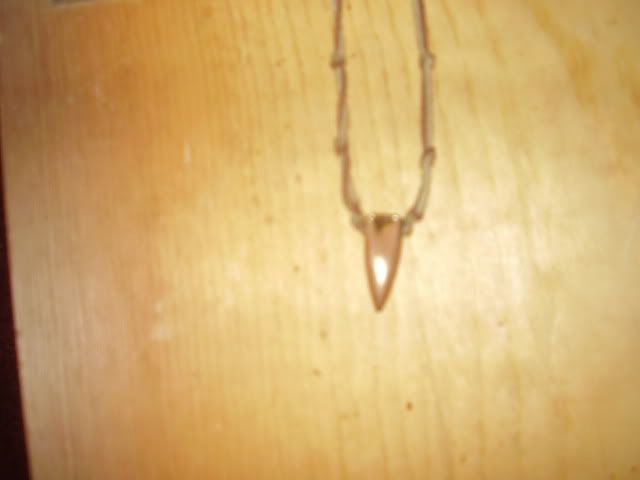

One of the rounds went through the 2x8 and a 12in poplar behind it and was barely hanging on the back side so i made me a cool necklace out of it.
