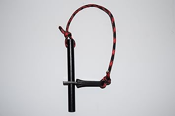

Optimal Ferro rods & strikers have a handle on them. For the same reason a knife, hatchet, hammer, screw driver, etc does. A handle allows a user to apply more strength, leverage & torque, so-as-to utilize the tool much more effectively.
A handle also allows a user to utilize (abrade) the full length of as Ferro rod, whereas, without a handle, the user must grip the rod with his fingers covering a good part of the rod.

This is my design for a ferro rod. 30-06 case necked to 6mm with a 1/4" x 2.5" rod press in with epoxy. The head is drilled and tapped for a grade 5 bolt I lathe cut to a square edge so it could be used as a scraper. A red rubber gasket completes the waterproof seal for the waste gunpowder contained inside. Its enough for 10 emergency fire starts. I have a new one using a 50 BMG case a 1/2" x 6" rod.

If you want to put handles on them, go to about any Dollar store & buy a few kitchen utensils for a buck each.
Saw off the handle, drill a 1/2 inch diameter hole in its business end (5/8ths of an inch deep) & super glue the rod in the hole. If you want a retractable one, go to Lowes or HD and buy a $6 Dixon tinder crayon holder (bore is 1/2 inch).
Simple, inexpensive & very effective.
