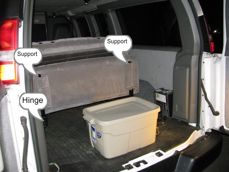

Has anyone ever routed aluminum with a homeowner's router? I'm brainstorming how to fabricate an extension to support a seat cushion. Here is my attempt to give you a visual:
This isn't the best pic but that is the sofa bed I'm getting ready to install in my van. The cushion that is labeled folds down (toward the rear) to increase the size of the bed platform. I have an additional cushion that I can lay in behind that one to extend the bed platform even further (50"x74" total) but I either need to build a frame to support it or extend the supports pictured. My thought was to just extend those existing supports with matching square aluminum tubing with channels cut in the side to allow them to slide. The tubing would be bolted through the channels and onto those supports with wingnuts to secure them in place. The wingnuts could be loosened to allow the aluminum supports to slide in or out when needed.
I was looking around at how to machine the channels into a piece of aluminum and found bits for a standard router:
http://www.toolstoday.com/p-5801-so...inum-cutting-up-cut-down-cut-router-bits.aspx
I want to cut channels like in the 2nd pic. I'm curious if anyone has ever used a router to machine out light gauge aluminum and has any tips, comments, warnings?
I could use my drill press and do many overlapping holes to create a channel as well.
Thanks!
Thanks!
