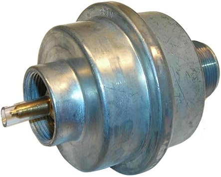

I suggest if you go with the bulk tank .... get their inline filter regardless of what the hose claims.
"some hoses claim no filter needed"
I dunno about that ..................
Yup, inline filter!
Buy from any local hardware or farm supply for under
$10
Here's an Amazon picture

Yep I had big Issues getting the filters and the Hoses and the Heaters, In the end I bought my Portable Buddy and the Filter from the US, here they are 3 or 4 times the price where that little filter is over $120 USD,
I've seen the Big Buddy for 5 to 600 Dollars USD, @£517.27p OR $631.07c USD.
These 3 Items should be here in a week or so, But I already have the Little Buddy and the Filter which I Ordered a month or two ago,
I just paid £264.73p for the Big Buddy which is equal to $322.97c USD including shipping from the US and I think that involves Import Duty as well,
The 10ft Hose Non Filter Type P/N F273704 is also on the way over from the US, This has cost me £56.81p OR $69.30c USD,
And I have also ordered the 12ft Hose with the Regulator with the Quick Couple Connecter P/N F271803 For the Big Buddy, Having a Regulator Built in to the Hose Mr Heater say it does not need a Filter and there is no way for you to fit a filter with this Hose setup, But It is also on the way from the US and it has cost me, £97.03p OR $118.37c, Some of these Items I can't even get here and the Only place I have seen some parts they want 3 to 4 time the US Price and Double what I paid including freight from the US, which is a Joke,

I would recommend doing some research before using a larger tank and hose or buy the hose and fittings from the manufacturer. If I understand it correctly propane will leach oils from some types/brands of hoses and over time damage the heater.
That's what a filter is for. I would get the type of hose that doesn't require a filter.
I use the big buddy heater in my ice house for heat. I use a hose and filter and connect to a 20 pound tank. -20 zero outside and I’m sitting in a tee shirt. They really work great. These have a low oxygen sensor in them and shuts of the gas if your area is too sealed up. I also use a CO detector. If you use one of these be sure to use the correct hose and run with a inline filter.
