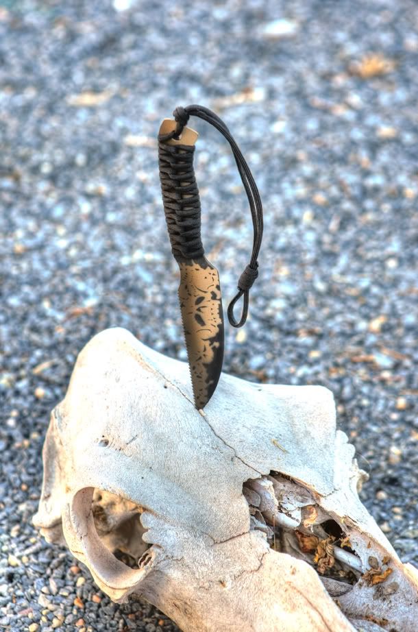

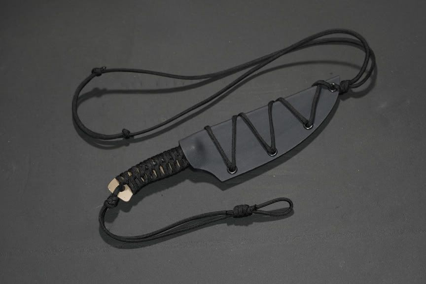

Lots of posts about these lately. I have been making these for about 8 months now. Mine are actually made from a little bit bigger blade than a Sawzall, but the same idea.
I made a couple of these one day to carry in my hunting packs for a backup knife. I have never advertised them for sale, but I can't keep up with demand. Once people see/play with them they want one.
I sandblast them, then I use Duracoat firearm paint for the finish. (They rust within minutes after sandblasting them if they get wet) I have Parkerized them as well but I wasn't very happy with the finish. They hold an incredible edge.

Thanks for the comments. I have never had one bend. These are thicker and much more stout than a regular Sawzall blade.
I went through a lot of different brands of blades before I found one that was fully hardened. They don't flex much like you think they would. (They are just under 1/8'' thick)
Thanks everyone. DMAC- These are the best I have found. I ordered 100 of them from a local supplier and got them for around $6-8 each?? I'm out of town and can't remember right now. (it seems like it was just shy of $800 shipped) You can get two knives per blade but the teeth are backwards on one of them:D: Some people prefer them that way so its not a big deal.
It seems like mine are 8tpi. They cut wood, steel, plastic, pretty much anything.
I also bought a couple of really big Starrett blades (2'' tall) but the spine was soft on them.
